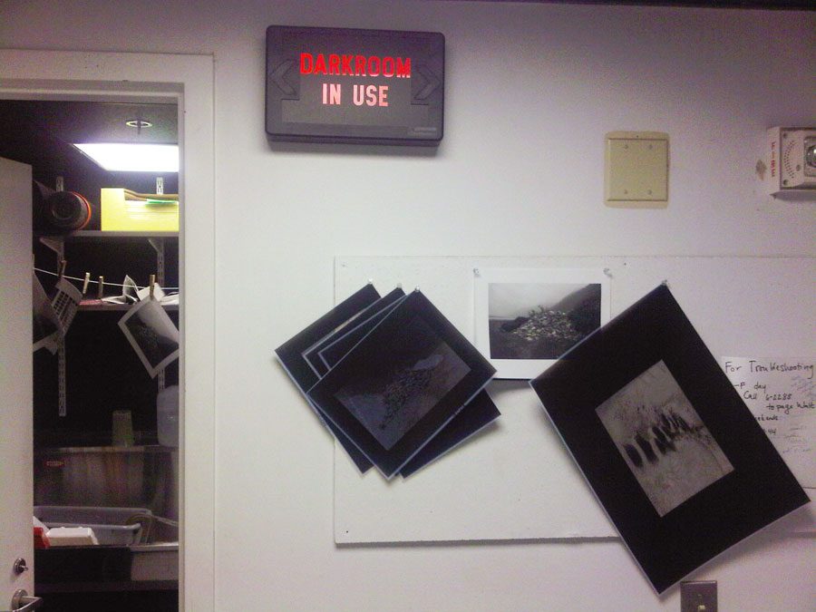

Two weeks ago when I entered the darkroom, I began to reduce the dynamic range of the film from 3.0 to a more useful range for making a digital negative – something around .13 to 1.70. Although my original curves process can be easily adapted to making a digital negative, I wanted to devise something that was perfectly suited for making a replacement of a silver negative. I wanted it to behave the same as a silver negative. I wanted it to even look the same as a silver negative.
I wanted to try and see if it was possible for me to do to digital negatives what I did to quad black printing with the Piezography system. My goal is to have a positive  image print directly through QTR onto Pictorico Ultra OHP as a film negative and then be processed in the darkroom as a silver print in a way that was masterful, yet easy.

With this new QTR curve methodology I am able to print negatives that make silver prints that I am very pleased with. I am using a particularly difficult digital image I shot at Chungde Beach in Taiwan. The sky is gray, the beach is black, and there is a huge pile of gray valued stones. There is detail in the black sand, the dark foliage near the stones. It’s a very demanding grayscale file that has endlessly long shadows and highlights. It’s a perfect candidate for Piezography printing, but I would have considered it a bit difficult for silver printing if it had been exposed as a negative. I don’t believe I would have been skilled enough to expose and develop this range of tone. I studied both the chemistry and densitometry of the Zone System. I don’t believe it is possible. And were it, the silver paper is always more challenging.
I had a silver print made of my digital file using the latest in photographic laser technology. While the print is amazing, it did close up on the shadows in comparison to my digital negative. It actually looks more like a traditional toe/shoulder result. Whereas my new Digital Negative curve linearizes this region. And the comparison of my digital negative print to the sharpness of the photographic laser print made me realize how much a vacuum frame is needed for making tack sharp contact prints with digital negatives. Pushing down against the glass just does not cut it! Do I really want to buy a vacuum frame? Do I really want to go back to the darkroom? So what is it about silver print?
I am making darkroom prints that I could never have imagined making from silver negatives. It’s almost as if the heart of the paper is a grade 2, but the shadows and highlights are being printed on 000 (if they made such a grade). A friend commented on them making me think that one would have to do some crazy masking, working simultaneously with multigrade filters in order to accomplish something like this.
