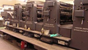

Heidelberg presses at Steinhour
One solution is to use more shades of black ink. I think about the wonderful duotones and tritones which The Stinehour Press of Lunenburg, Vermont produced. These books were printed with multiple shades of black ink on Heidelberg presses using an incredibly fine halftone screen of 300lpi and which produced images much closer to continuous tone. They arranged the overlapping dots of ink in such a way as to avoid moire patterns and it was very difficult to not see continuous tone. But, as good as it was, it was still not darkroom quality.

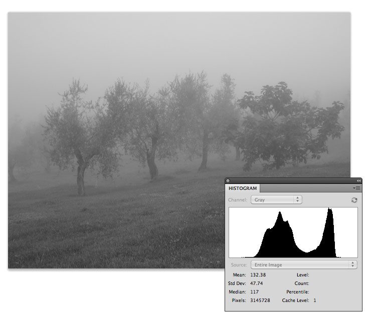

If you’re still with me…the following digital capture taken on a foggy morning of an olive grove does not have 256 gray values. So we know already that we can make photographs in narrow dynamic ranges when the image necessitates it. Most systems can print this type of range without too much trouble provided there are enough light ink shades. Piezography would image this with thousands and thousands of gray values – created by the overlapping of so many carefully linearized ink dilutions. This type of output is close to the needs of the range of tone required in a silver negative. It is however represented as a positive instead of a negative. It is here to illustrate what happens when you put a silver negative on a light table and look at the very narrow range of density from film base+fog to fully exposed leader film. It’s simply, a very narrow range of density – and exceeding it only makes things harder once it comes time to printing it.
A narrow dynamic range of gray values…

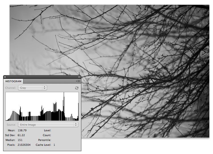

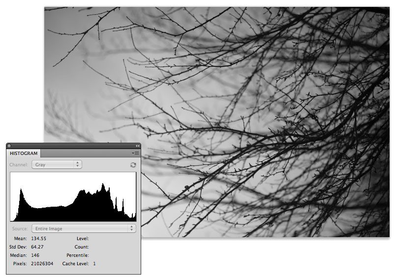

So finally to gray values and compression…
Full dynamic range image…

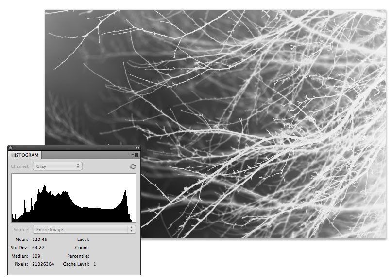

After inverting the image in preparation for making a Piezography digital film negative the dynamic range of tone is simply reveresed.
Inverted image….

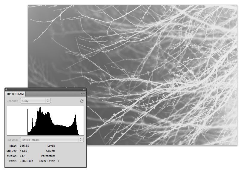

If the entire dynamic range of gray values is printed to the K7 film curve, the density range will be too high. The black will be far too opaque. Even the three quarter tones will be too dense for silver paper to realize any subtle separations. Therefore the end-points must be adjusted. And then a curve created that produces a negative that corresponds to the non-linear properties of silver. Those properties are affected by the process each photographer maintains. So there is no catch all curve. But the first step is to make a reproduction of a negative. That reproduction does not look like a full dynamic range image that has been inverted on a display. The corresponding histogram in a process like this does not reveal gray values thrown away, but rather as compressed.
Compression of dynamic range…
We need to print a range of tone when making a silver negative that is directly related to the needs of the silver print to produce a wide dynamic range. We’re not actually throwing gray values away. We’re compressing the tone range from the excessive range to the correct range. The contrast of a negative is quite low from dMin to dMax – yet it produces a greater contrast in the print. Dropping the Photoshop image from its 4.0 display dynamic range to that which is appropriate to a silver neg will result in a full dynamic range silver print. Otherwise, dithering of darker inks will be required and this tends to lower the prospects for con-tone.
