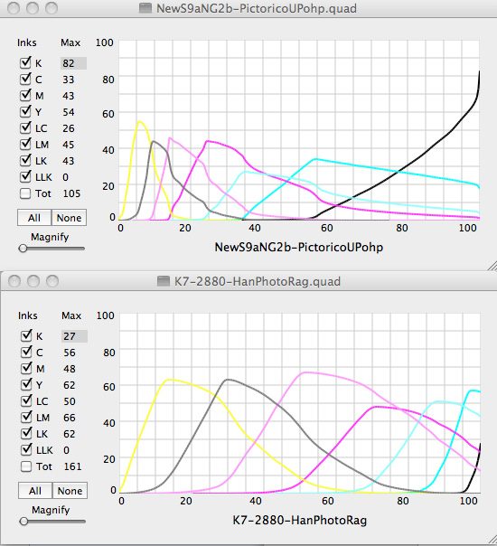

You are looking at QuadTone RIP curves which I have made for Roy Harrington’s QuadTone RIP software. The curves are actually a composite of seven individual curves that control the output of each inkjet head. Each curve represents a shade of Piezography ink. The darkest shade is on the right and the lightest shade is on the left. A very good explanation of QTR curves can be found in the blog by browsing the Piezography K7 inks and K7 curves category for Piezography Profiles. Notice that although this is an eight ink printer, there is no LLK curve. That position in the printer is reserved as a dummy containing PiezoFlush or as a Gloss overprint channel containing GO. It gets a curve all of its own. The curves are represented by color position rather than shade.
The curves architecture for film and paper are dramatically different.
The QTR curve for Pictorico film at the top features a very heavy black. Shade two (in the cyan position) had to be diluted lighter to fill in the gap between black and shade 3 (in the light cyan position). Shade 4 (in the magenta position) also had to be diluted lighter to fit between shades 3 and 5 (in the light magenta position). Shades 6 and 7 in light black and yellow positions complete the linearization.
Below the QTR film curve is the QTR curve for Hahnemuhle Photo Rag. It is very smooth and seems to not have any lumps and bumps because the Master Curve was created on this paper, and it has needed only a slight ajustment. All curves that we create produce fantastically smooth output no matter how lumpy and bumpy they look.

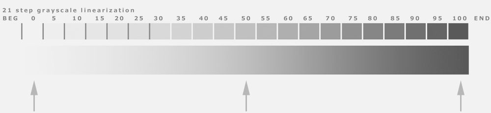

In making a digital negative with Piezography digital film process, you need to find these values by printing a step wedge through QTR using the curve NewS9aNG2b-PictoricoUPohp.quad. This is going to result in a perfect representation of the step wedge and this is not ideal for darkroom process. But it is ideal as a base for your final digital negative files because of the vast increase in quality as compared to competing systems.
You do not need to buy a digital file form PDN in order to do this. QuadTone RIP supplies a 21 step wedge and a 51 step wedge. Using the standard 21 step file from QTR, making a Piezography digital film and printing it in some darkroom process might produce a print that looks like the below:

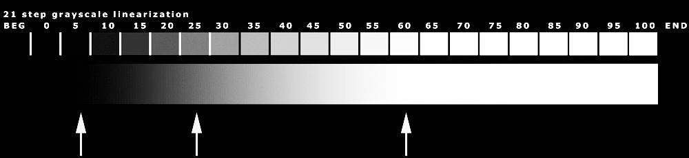

The digital film exposed as silver print.

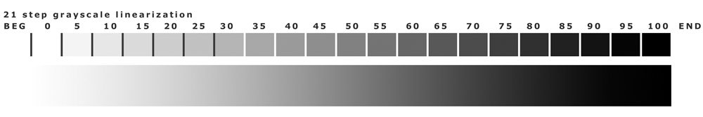

The three points are to illustrate the desired dMin, 50% and dMax. Remember that 100% ink density produces white and 0% density produces black. These are “negatives”. The same process is reversed in figuring out a film positive for processes such as photogravure.
By simple analysis, it appears that 65% input gray will print as pure white on this particular silver paper/chemistry combination. All of the density from 65% to 100% does not print and is lost. So we need to take 100% density (which we might have thought to be our specular highlight) and move it to 65% so that everything below 100% density in the original digital negative file can print with detail in the silver print.
25% input gray produces a satisfactory mid-point. So we need to transform 50% density to 25% in order for our mid-points to print as mid-points.  And finally 5% input gray is produces a maximum black. All of the nuances in the 1-4% range are lost. So we need to take 0% gray (pure black) and move it to 5% as this will become our pure black once it is printed in silver. Anything lighter than this will now print with some detail.

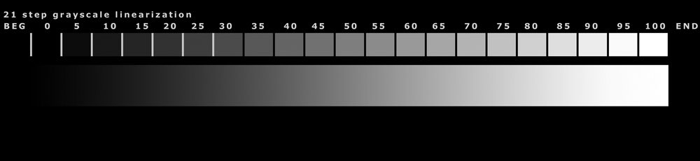

How one makes the curve is to determine the three points and make a compensation in Photoshop curves. You would use the previously silver printed test strip from the Piezography digital film…
Moving these points that you found as dMin, mid-point, dMax to where they should be would create a Photoshop compensation curve that may look like this for the above example:
This is the curve that you might use on your inverted digital images before printing them to the Piezography digital film system were your process to imitate this example. But, it is only an example of a curve and it does not mean you do not have to go through the process yourself!
So, this Photoshop curve applied to the digital step wedge image file that is used to make a silver print would convert it to something like this :
The three points are now where we want them…
