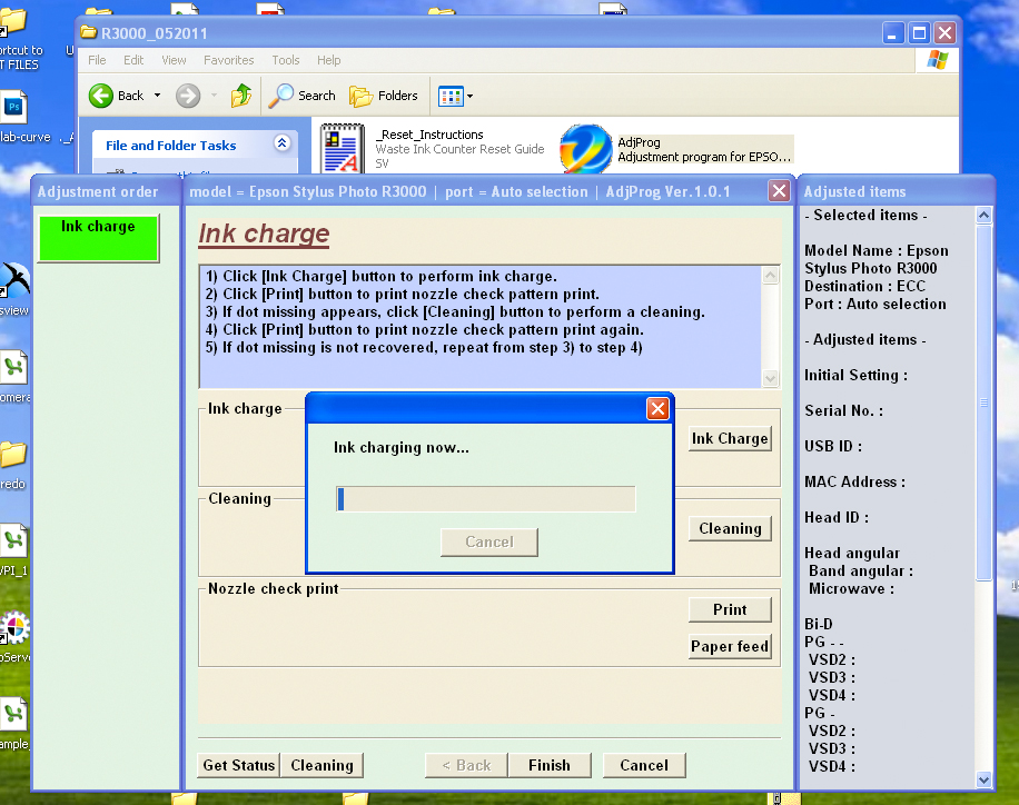

  5. Launch the Epson Service Adjustment Software and click on the Particular Adjustment Mode.
  6. Click on Ink Charge on the Maintenance Menu. In the Ink Charge Menu click on the Ink Charge button. The printer will now perform the original ink initialization. It takes several minutes. Between 15ml and 35ml of ink in each position will be charged through the system. Do not interrupt the printer or system. You will see a confirmation that the ink charge has been completed when it is finished.
  7. From this same window you can perform head cleanings and nozzle checks. You may wish to do so. However, if you can not get a clean nozzle check within 3 tries. Allow the printer to settle down for several hours. You can use the regular Epson utiltiy software or the printer’s maintenance menu to perform nozzle checks and head cleans.
  8. Verify that you have a perfect nozzle check pattern before printing images. The pattern will consist of six sections, of different shades of gray. The lightest shade, shade #7, is faint.Note: We recommend first flushing the printer to remove the color ink stain from the dampers. You would perform the Ink Charge to move the PiezoFlush through the printer and then a second Ink Charge to move the Piezography inks into the printer. Because shade 7 is such a light gray and is installed in the yellow position, you may see a yellow cast if you do not flush or perform at least two ink charges. The same is with shade 6 which is installed in the light magenta position. However, this stain will eventually be chased out in normal usage.
  9. Screen shots for Epson Service Adjustment Software using the R3000 printer is very similar the X900 utilties:
