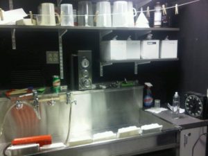

I chronicled my experience with the development of this system. I had been given use of Dartmouth University wet darkroom. I lived in there for more than a month. The system went through many permeations.
