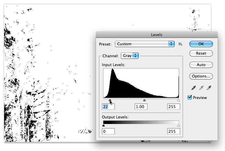

Another way of looking for dMax, and one which is more visually intuitive, is to look at the image black levels using the black point Input slider of the Levels tool. When Levels is opened as in the illustration below, the same histogram is presented in the Levels Window.
If you press the alt or option key while clicking the mouse on the Levels black point Input slider, the display image will show white except for those pixels that are at or below the Input level selected. In this case in the illustration below, an Input Level of 0 reveals that the 4,092 pure black pixels are incredibly hard to notice.
In fact, I need to click and drag the black point Input slider while simultaneously pressing the alt or option key to nearly the Level 22 point before I actually notice a sizeable amount of pixels. This Level 22 area however represents 94.5% gray. You can see this in the illustration below.
So, my choices here? Live with endless gorgeous ever darkening grays, or compress everything from 94.5% to 100% together in order to form a larger mass of pure 100% black. I can do so if I choose with or without regards to the other grays near 94.5%. Or, I could just leave gorgeous near blacks be. I think by now, the reader can foretell my choice. Though, I may be tempted to finesse something in between these two choices with my technique.
