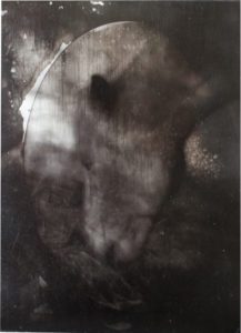

My first tintype was an old family portrait made from a photograph taken from my mother’s Zeiss Ikon when she was a young girl at Shoreham Beach in England. My second was a portrait taken of my mother when she was three years old. Instant family treasures can be made quite easily with this process. But, my real challenge was to make a tintype that I felt had some potential as a form of photographic expression. To that I began working with very dark images. I quickly realized that pre-printing all the film was a bit of a disadvantage because the process has a definite gain of about 1 or 2 stops in the mid-tones. I used my digital negative ink set and the Pictorico OHP curve.
If I wish to use this process in a calibrated manner I will probably produce a Piezography curve for it. But, a simple Photoshop lightening curve for the mid-tones will suffice. I made an image that I truly liked. As I show it around, many people can not decipher what it is. I see it. Others don’t quite. I’m not sure, but I think that may be a sign of success in this particular work. I wanted it to look like something aged and mysterious. It’s a portrait of a horse from a photograph by Cathy Cone. There is an outline that looks like it’s from an overlay oval cutout that frames the head…but it all melds into dark carbon. A strong light in a dim room however, reveals such a beautiful and subtle photograph.
