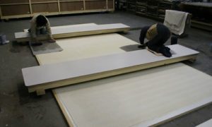

Probably the most significant factor is sheer sensuality. Paper has always been attractive to artists as an object with a look and “feel” that is essential to choice. Holding a sheet between fingers and feeling the texture is part of a sensual experience. It’s a different experience from the texture that the eye sees. These sheets weigh several pounds each. Even a 44″ x 78″ sheet weights more than 2.5 lbs. They’re objects. Thick. They can stand against the wall “Diggin’ the scene With a gangsta lean” (in the lyrics of William DeVaughn).
They’re thick. They’re not pulled from a vat of slurry like Western paper. These papers are moulded and scultpted with trowels. The kozo and cotton slurry is poured on and smoothed out over a giant mould. The deckle then fitted to produce what I think is the most beautiful deckles ever. And the surface texture is obviously not patterned. To the contrary, each sheet is unique.

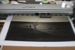

Printed triple-thick Japanese handmade kozo/cotton
The paper is nearly 4mm thick. Can’t go through an Epson, HP or Canon. It really can’t go through my Roland. But, I modified my Roland to print this paper. I raised the print heads about the height of two pennies. I also had to raise the capping stations and the cleaning station. My Roland is a 64″ solvent printer that has been outfitted with pigment aqueous inks that I make. I choose the solvent printer because it has a paper heating base. I can heat the paper up so that the ink dries nearly on contact.
Close up of a printed image. Tons of dMax for an uncoated paper, produced by printing on the heated paper.
The paper does not have an inkjet coating to prevent bleed and spreading. Heating is essential and it allows me to increase my ink load appreciably. This paper is far more archival than the modern inkjet papers from Epson (Signature Series), Hahnemuhle digital fine art papers, Canson, Moab, etc… The presence of an inkjet coating, much like gelatin in a silver print, will always maintain a hydroscopic presence soaking up atmospheric pollution. We know from experience, that the modern inkjet papers outgas and that they are highly susceptible to the presence of gasses around them. Some inexplicably turn yellow for no apparent reason. Some stain after coming in contact with plastics, steel, etc…

Printed in ink separations simultaneously on a Roland 12 ink printer. All custom process – all custom inks.
