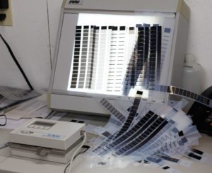

To design this new curve set, I had to gather all my tools including cartridges filled with ink dilutions, a suitable small format printer (the R2880 is quick and easy), an X-Rite DTP32TF transmission auto-scan strip reader, my softwares.
I designed a set of strip targets that were compatible with my Piezography profiling system.
Ink limits target for QuadTone RIP
256 gray steps for DTP-32TR

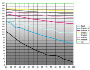

The first step is to measure and plot the ink densities on film. I create a target file that can be used with QTR Calibration mode but is read by the DTP-32TR rather than the Eye-One (can not read transmission). The measurements are plotted as a simple graph that show 5% increments of each ink shade. I use something as basic as Excel for this. At the same time, but in a separate software, the total inks are analyzed for bleed and sharpness.
The goal is to determine how much total ink I can get away with and not produce bleed or spread. That will control the combination of densities that I can overlay. I also need to determine what is the maximum useful density that I can depend on with each of the ink shades. That individual maximum ink density is the top point of each ink’s curve. That is also the point that falls along the diagonal line from dMax to dMin. A lot of stuff to control.
In this case, both the dMin and dMax were going to be sharply reduced from my first version of digital film. Darkroom photographers do not need a wide dynamic range of density in their negatives if they are printing to silver. Rather, a very specific dynamic range is required: nothing darker nor lighter than that point that produces absolute paper black or absolute paper white.
I set my dMax at 2.50, and I set my dMin at 0.27. These two density points in this particular Piezography ink set are the points required for silver to begin building tone between them. With a particular ink option, my first version printed from 3.2 (opaque) to 0.09 (about Pictorico average).
Between these to end-points, I plot the densities of the additional shades of ink required to make smooth transitions. In this case, shades 2.5, 3, 4.5 and 5. How much of each ink sets the height of each curve, how quickly that ink comes in sets the front slope of that curve, and how quickly it stops printing sets the back slope of that curve.
