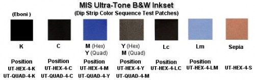

The Digital BW, The Print is now mostly comprised of users of color ink sets that have two or three shades of black. These ink sets are either in the form of a warm/cool color scheme (like the system illustrated below made by MIS) or have cyan, magenta, yellow inks (made by Epson, HP, Canon). These users actually produce black & white prints that are comprised of colorizing agents. In other words, they can make one ink set appear warmer or cooler by adjusting the color component inks when they are printed through software. While the printer may contain an ink set of up to seven and eight ink positions, they are using only two black shades (usually) or three (occasionally) for actual grayscale tonal division, while the other inks are color and employed to create the final tone (color) of the print.

In the following illustration is the MIS UT7 curve for producing a sepia black & white image on Premier Fine Art paper using the MIS UT7 inks with the QuadTone RIP software. Notice that only the yellow and black ink positions are used. The black ink only must carry the entire range of grayscale while a warm colorant is used for color tone.
MIS UT-7 ink curve for Sepia on Premiere Rag.
