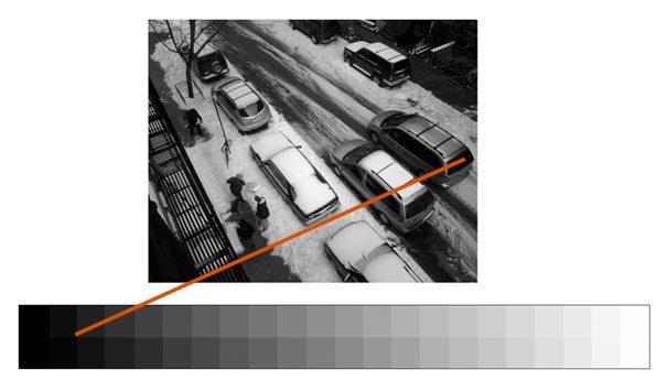

When it comes time to look at an image on a monitor. What assumptions are you making? The quality of your calibration determines the shadow separation which you can see. The image should print just like it displays, and will if you are calibrated. But, what happens when you see a dark gray as black as depicted in the following graphic?
Is it really black? No its a dark gray...

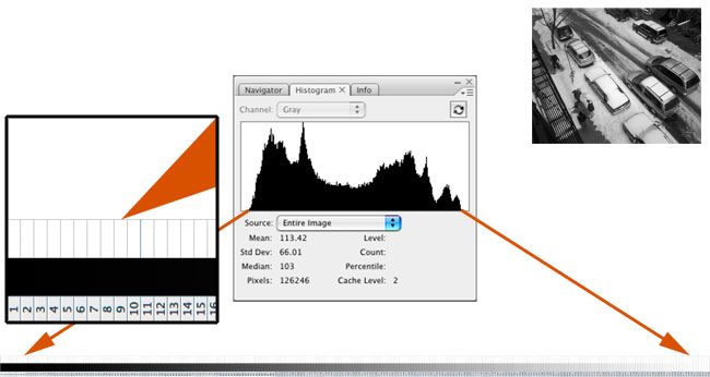

What happens is that the “black” which looks “black” actually prints as a dark gray because it really is a dark gray. Take a look at the following graphic. Because the histogram of this image file reveals that this image actually does not contain any “black” at all – even if it “looks” black on an improperly calibrated display.
49 pixels of RGB value 9 represent the darkest gray in the image. There are zero black pixels (RGB value 0). The majority of the dark tones in this image file are actually in the 3/4 tone zone. There should be no expectation that this image will print a decent black. By the way, there are also no pure white pixels – but photographers seldom which to push the highlights as they do the shadows. Yet, Piezography is unique in printing magnificent highlight separation and detail.
