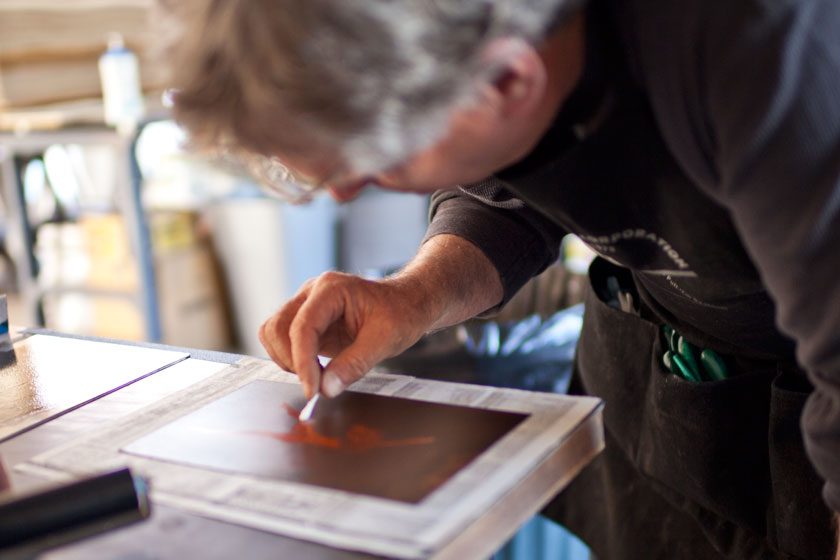

Hand wiping the plate after it is inked is very much in the traditional method of wiping aquatint plates. But, Don will not use his palms – always adhering to safe methods. Smart man!
Don patiently worked on my hot spot highlight that actually had quite a bit of tone. It turns out we could just make a Photoshop adjustment and another plate in about 30 minutes!
